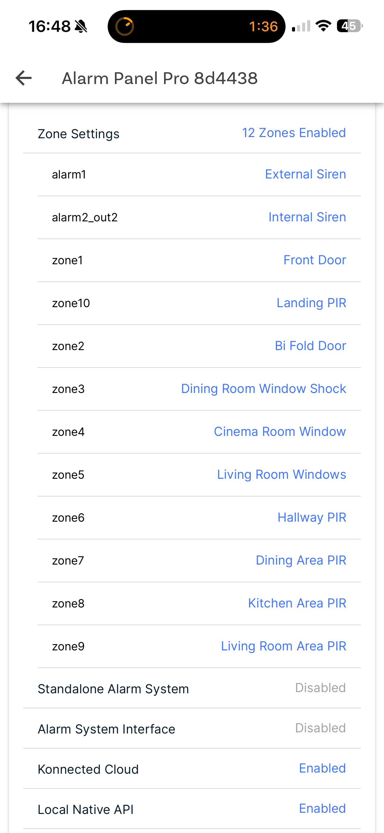

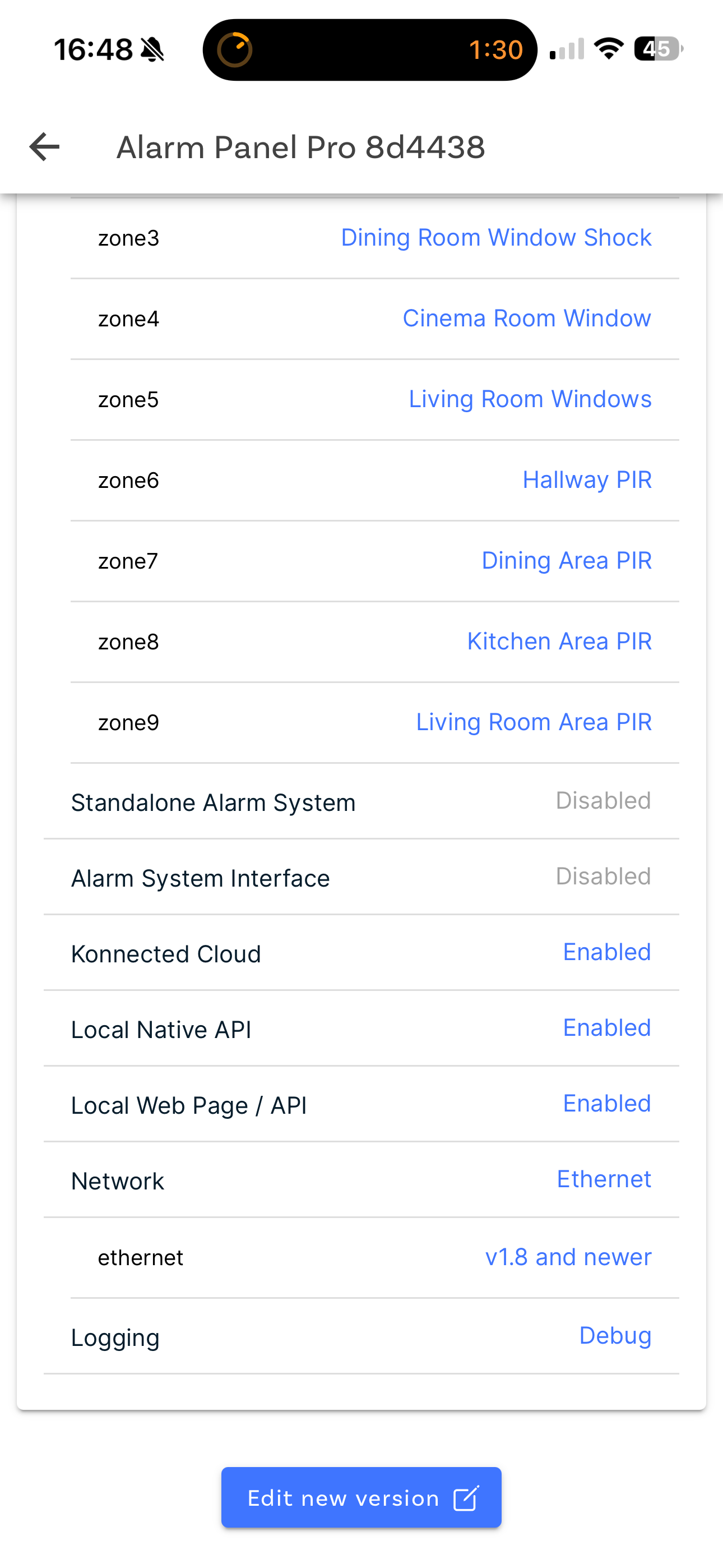

As for the S, its seeing it on the konnected board and letting me add it to the build as a Tamper circuit but the smart things just isnt getting it pushed through. Ive deleted it, rebuilt the firmware and refreshed till im blue in the face. Ive checked the wires and they seem correct and the sensor is actually operating as is shud when i hit the window. Any ideas please?
