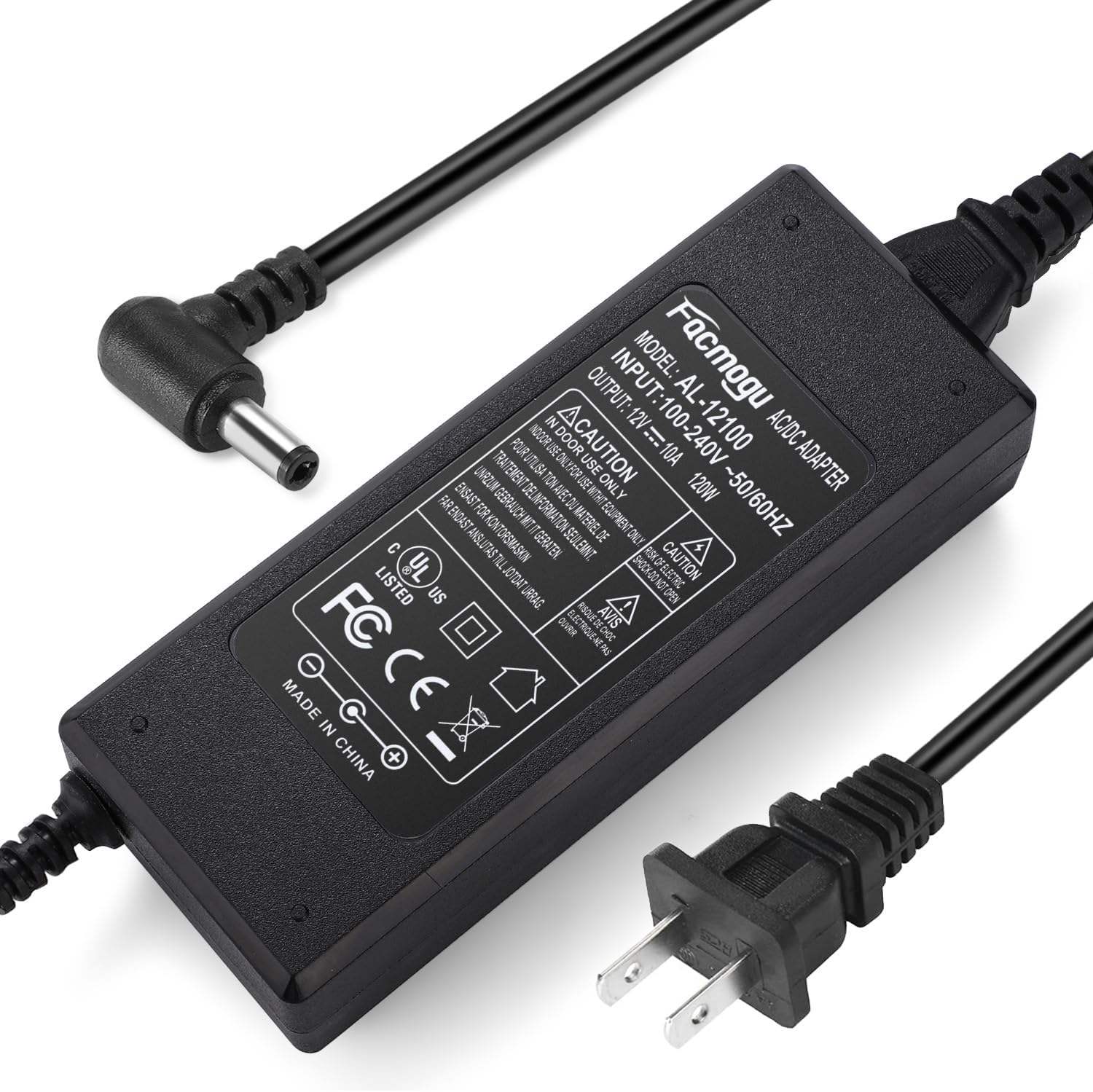

After some research, I decided to buy a 12V, 10A power supply (laptop charger style) and split it 6 ways - 4x tablets and 2x Alarm Panel Pros. Theoretically, this should provide enough power to each Alarm Panel Pro and each tablet.

I’ve been meaning to report back. Hopefully this helps someone in the future. I can confirm that a 12V, 10A power supply will power 4 tablets and 2 Alarm Panel Pros with no problems.

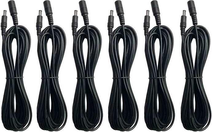

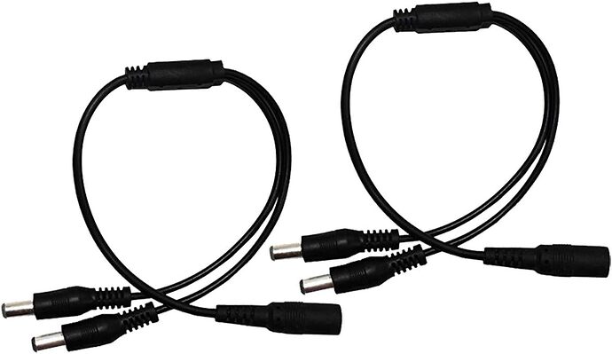

I found the power supply on Amazon with the same barrel connector that the Alarm Panel Pro power supply had. I used a 1 to 6 DC splitter. I needed a few DC power extension cables to reach various places. But basically just plug and play from there.

Power Supply:
1 to 6 splitter:
DC power extension cables:

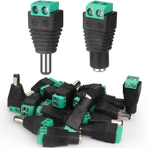

12C DC Adapter plug (converts wires to female DC plug):

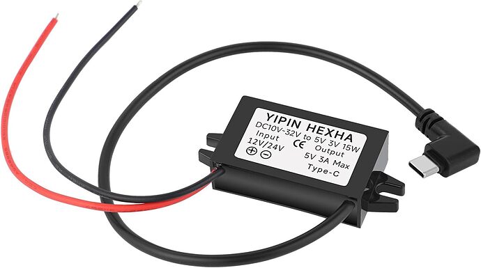

12V to 5V Step down block:
