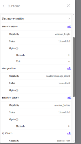

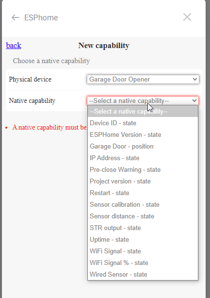

Good morning Ron,
These are the items exposed to me in ESPHome on my GDO White v2.
(please see the picture below)

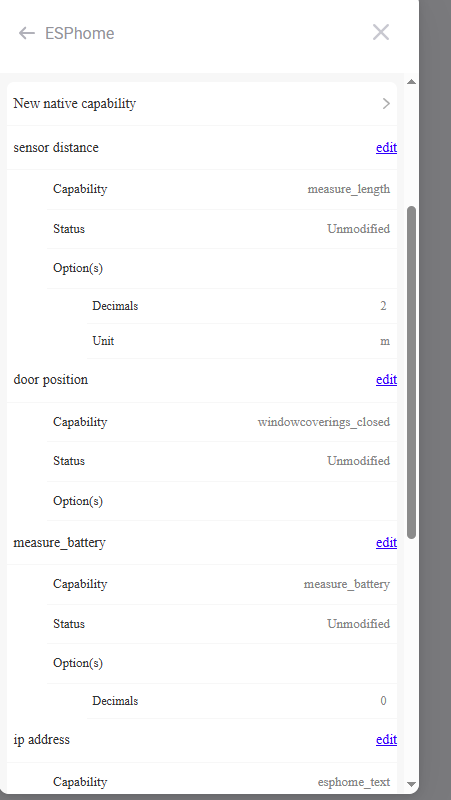

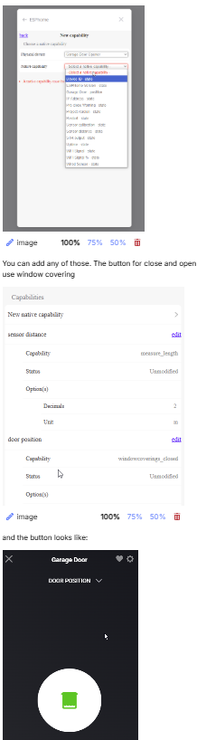

You can add any of those. The button for close and open comes Door Position and you can use window covering
and the button looks like:
While it looks like a boiling pot of water, this actually shows a closed window shade. You click this button and it will open the garage door.
I hope that helps.

Here are the items I show exposed:
This is the door position screenshot
@Theckman Thanks for your info and patience. I’m finally getting back to this. I have the Garage Door - position (open/close button) added to ESPhome. It works on the Homey side. I’ll be able to create a flow for open/close and use the Re-close Warning.
