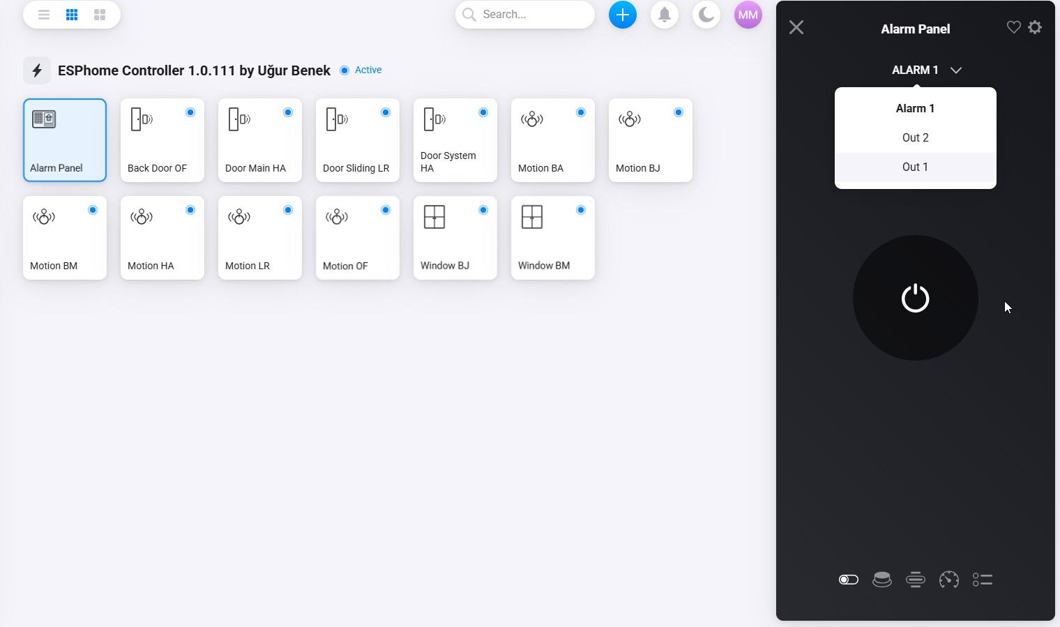

!!! VICTORY ON ESPHOME CONTROLLER HOMEY APP VERSION 1.0.111!!!
After 36 builds in 5 days, @ugrbnk managed to fully support the Konnected Alarm Panel 12 Zones.
That means the 12 zones, the 3 outputs and even the RESTART button :star_struck:
Too tired to write more right now, but a HUGE thanks to U­ğur for all his efforts and kindness. 36 new builds in 5 days, but the result is worth it :smiling_face_with_sunglasses: :smiling_face_with_sunglasses: :smiling_face_with_sunglasses: Sleep tight and CONGRATULATIONS!!!
@nate Wake up :face_blowing_a_kiss: , Konnected Alarm Panel 12 zones fully supported on Homey now :hugs:
Dear Homey and Konnected fans!
I am glad to let you know that the new ESPHome Controller app from Uğur BENEK @ugrbnk now fully supports the Konnected Alarm Panel 12 zones:
  • Full support for the 12 Zones, 3 Outputs and even the Restart button
  • Support for Konnected new Standalone Alarm System mode and probably also Alarm System Interface mode, will confirm when my interface modules arrive
  • Encryption and Alarm codes supported
  • All Flow cards implemented
You can find the new app at ESPHome Controller | Homey and huge thank to @ugrbnk for his hard work and dedication on this (45 test builts in 7 days!).
Main thread is on [APP][Pro] Homey Pro Esphome Controller App - #99 by MarcM - Apps - Homey Community Forum for full details of this adventure :slight_smile:

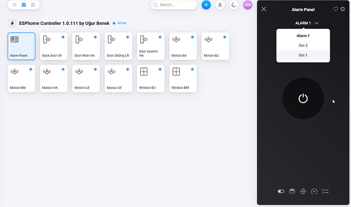

After a challenging process, I am delighted to offer my full support. Thanks to @Marc’s feedback, we managed to add it.
I just loaded this app and have both my Alarm Panel Pro 12 Zone board and my 6 Zone Alarm Panel working great on Homey Pro. It picked up all the Zones, Sirens and Alarms.

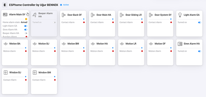

After weeks of intensive back and forth implementing, testing, and fixing, I can testify that this Konnected Home Security & Garage App is now rock solid, managing pretty much anything supported by the Konnected Panels:
  • Standalone Alarm System or Alarm System Interface modes
  • Alarm Arming codes, API Password and Encryption Key
  • Full device information, including ESPHome version, Konnected Project version and even Reboot reason!
  • Quick and handy Clear Alarm push button
  • Multiple panels support (I tested on 2 x 12 ports panels)
  • All Konnected sensors types supported (I tested Door, Window, Motion, Fire/Smoke, Carbon Monoxide, Water/Leak, Sound and Tamper sensors)
  • Timeline notifications including Alarm type and Triggering sensor (Neigbours hate me now!)
  • All corresponding flowcards
Thanks again Uğur for you amazing work and dedication, I am 100% sure the Homey Konnected Users will appreciate and hopefully will donate a little too to help you supporting it in the future! From my side, I will try to help new Users if it concerns Konnected 6- or 12-ports Panels (I do not have GDO’s).
