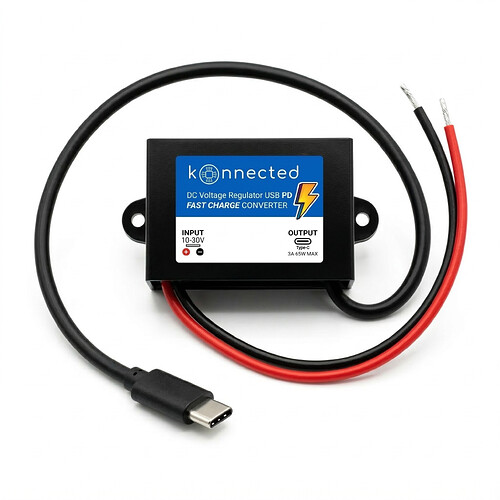

We do have a new USB-PD power converter available now!
