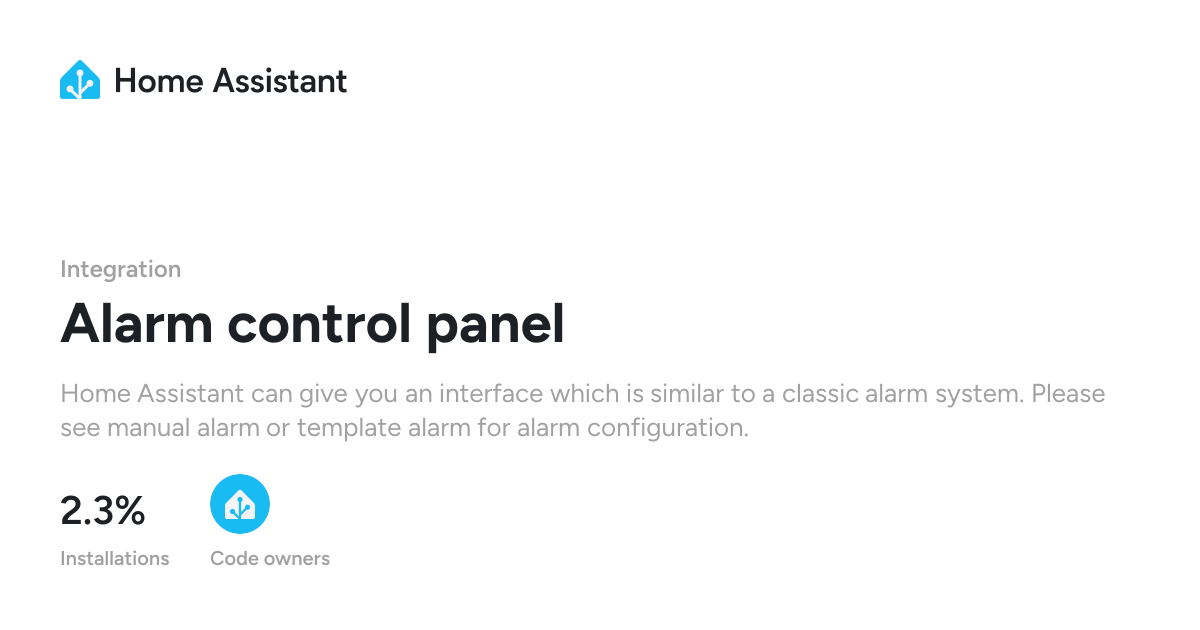

I think you should already be able to do this by calling the alarm_trigger action in Home Assistant in response to your wireless door contact opening. See:
Let me know if that helps or if I’m missing something.
