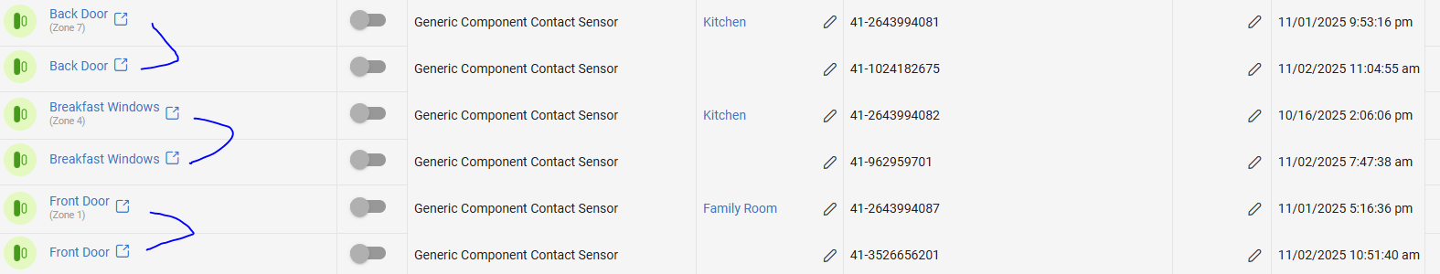

I updated to the 1.2.1.1 firmware and lost my devices updating the status. At first, the panel was offline and I found your thread showing an updated library. I updated that per your message and now the panel is online but I get no status changes from any device. Can you give me an idea of how to troubleshoot? Thanks!!
Looks like it duplicated all the zones.
The firmware version ends in .1 which indicates that this is the first build that you updated with the app. That means that this firmware is customized with your zone names built in (rather than generic Zone 2, Zone 2, etc) and that’s why they pulled in as new child devices. Most likely the original zones were using the generic names and renamed within Hubitat.
What you can do is delete the original zones and move your automations and rules over to the new child devices.
Or… go back to the app and rename them back to Zone 1, Zone 2, etc and update again, and the original child devices will reactivate and you can delete the newly created ones.
Thanks Nate!!
In Hubitat, I just edited the device id of the existing devices to the new device id. That way I didn’t have to redo all the automations and rules. Seems to be working!
