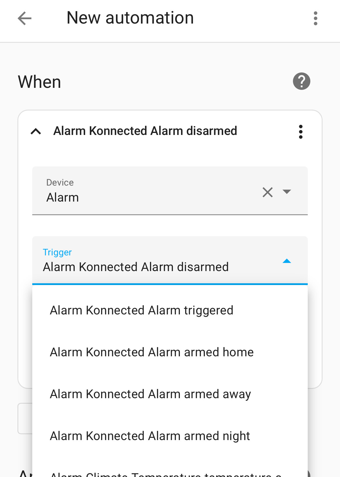

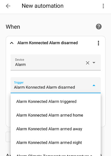

Hm I still cannot find the pending and arming states in HA. Anyone else got this to work so that during these states a sound or light signal can be triggered in HA?

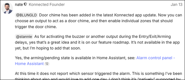

@nate , in January of this year in this topic, you said this to @stannie
So I’ve been searching the forum and can’t find the answer to his question. Thinking that there has been a lot of app software and/or firmware upgrades since January, today I setup the standalone feature using the current app software (1.6.5) and firmware (1.2.1.9) to see if this option was available in the setup, or maybe just defaulted in the firmware. I didn’t find it in the app and it doesn’t work when testing with this latest firmware build. While the door chime works fine, turning on the warning buzzer during the entry delay/exit delay/pending alarm does not seem to be an option in the app setup.
Researching further, it seems all the correct code (to turn on a warning buzzer connected to OUT 1) is already in the ESPHome Customization on the Konnected Alarm Panel Pro, and I think I understand that you use this as the basic logic in your firmware. I just don’t have the knowledge to load this firmware into my PRO board and will have to wait for the Konnected app to do it for me.
Or I guess the real question is has this feature been implemented yet and I just don’t see it? I do notice that the latest version of the app (1.6.5) was last released on Jan 29, 2025, so maybe you haven’t updated the app yet?
It seems like such a small thing and such a “of course my alarm system does that!”
Can you give us all an update on this feature please, and maybe a timeframe?
Thanks Nate!
