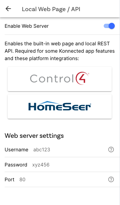

  1. If you’re not into managing YAML or learning ESPHome config and want Konnected’s done-for-me solution, use the Konnected app to customize your device’s build. The authentication option can be added, or the web server disabled entirely on the Local Web Page / API settings screen:
This firmware configuration service will be rolled out for the GDO blaQ in the next app update within a week. It’s currently live for the GDO White as well as our Alarm Panel products.
